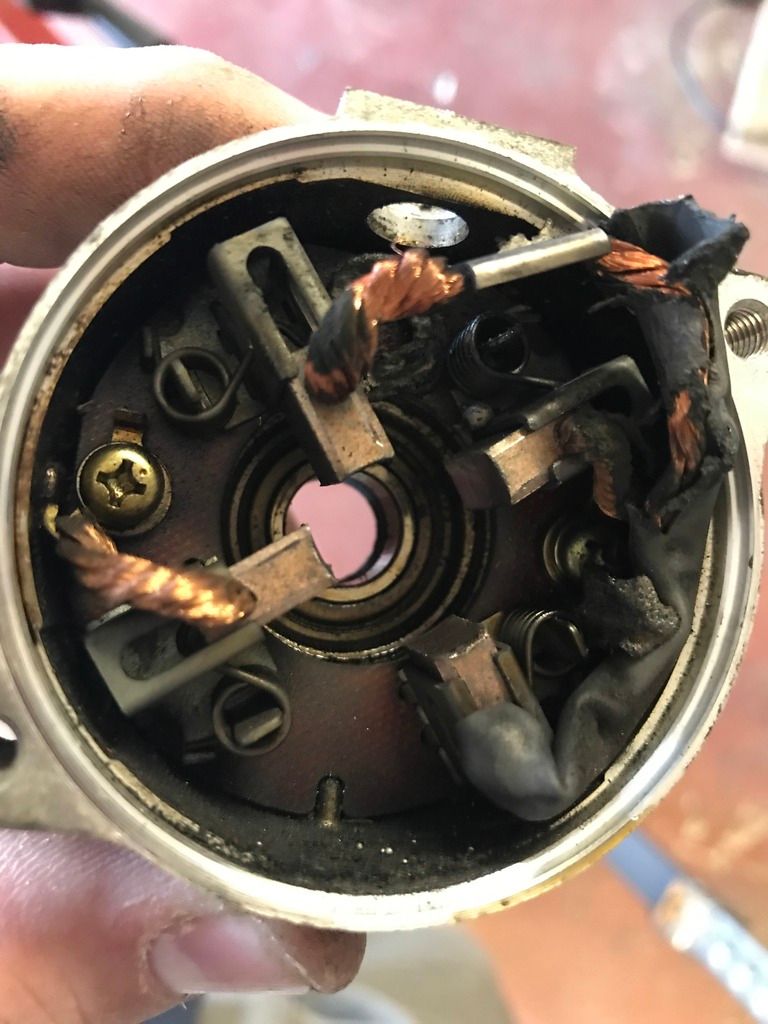

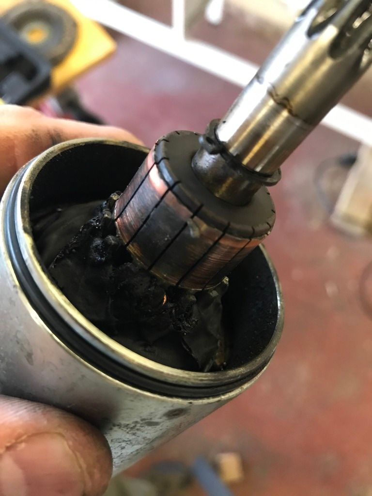

Hi all.
Thanks Jompy, Moise, Chappo and Newsh for your suggestions, really appreciate the help. I managed to get the starter out after some fiddling and much cursing. Was totally fried (see links below) been quoted the tidy sum of £540 for a new one from the dealer, which needless to say made me cringe a little. Just got to find a second hand one now and get the blumin thing back in.
http://i50.photobucket.com/albums/f324/ ... 5amoka.jpg" onclick="window.open(this.href);return false;
http://i50.photobucket.com/albums/f324/ ... x5ikue.jpg" onclick="window.open(this.href);return false;

Ouch! It's unusual for a solenoid to stick on, so it may be the starter switch or a wiring fault.
