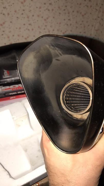

In regards to the noise, you can have the Akra modified to take a baffle as I have just bought 1 already modified. I've been told with the decat and this can it blows 102db
Here's a pic of said Akra with baffle

ColinBR wrote:In regards to the noise, you can have the Akra modified to take a baffle as I have just bought 1 already modified. I've been told with the decat and this can it blows 102db
Hi Colin
Many thanks for this, my borther is a fabricator and could probably help with this; do you have any idea how the baffle has been fitted? Is it permanent or is there a small alan key bolt to enable it to be removed?
