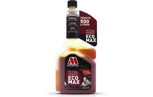

What fuel treatment do you guys recommend? The bike hunts a teeny bit at idle which i suspect is probably the pilot circuit but i'd rather try a fuel treatment and a good service before i have to start taking carbs apart.

:lol: :lol: :lol: :lol:
Posted same time :clap:

This would be my recommendation for a fuel system cleaner. Probably not in your local Halfords though!

You're right about Halfords but on ebay about £18 for 443mls. Looks and reads to be every bit as good as Millers.

polar wrote: Mon Mar 25, 2019 10:08 am
Jesus. This stuff’s gone viral. I'm going to put some more in. 😀.

Not that im getting paranoid about petrol degradation but each time I fill the jerrycan I’m dropping millers in and dating the bloody can with a sharpie!! Bloody Polar and his insider knowledge 😩

That Redline stuff can be had from eurocarparts for £16 with the their online discount at the moment which isnt too bad. I'll give it a go.
